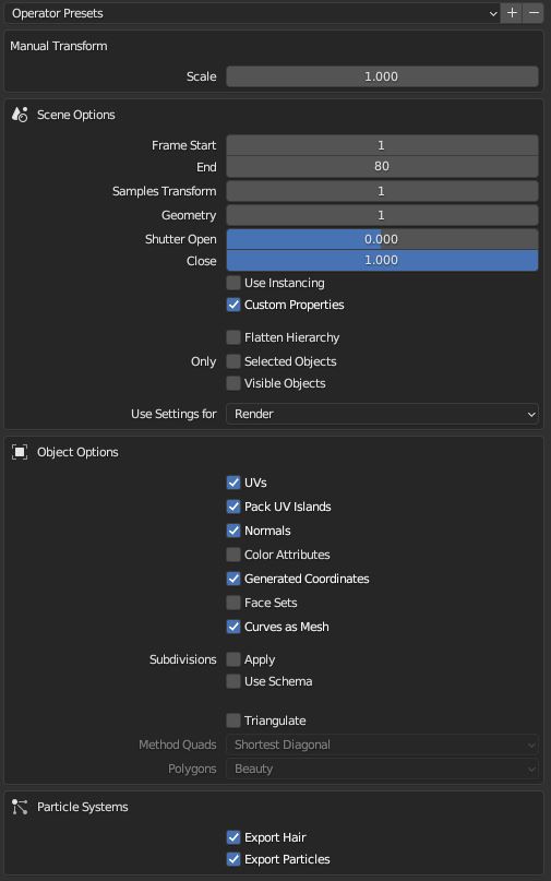

Hello, I have troubles exporting a blender animation into keyshot. It’s a translation animation of an object with tubes hooked up to it that follow the movement. When using the blender pluggin, the movement of the tubes is suppressed in the keyshot animation. So I exported the blender file as an .abc file with the following settings:
Once I import it into keyshot, the tubes move, but there are small shifts and it’s jerky. On the other hand, there is no problem translating the object.

I used the same settingsb ut also enabled ‘triangulate’ since that makes sure KeyShot won’t triangulate it if needed. Seems that works:
Hi Oscar,
Thank you for the tip. I’m really gratefull. It works perfectly!
